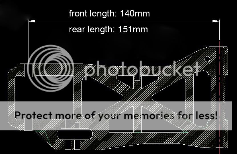

Sain tehtaan isolta päälliköltä viestiä juuri:
Lainaus käyttäjältä: NUTECH RACING
Dear dealers,
We received some complaint of MT plastic suspension arm's size were too short.
we are fixing the mold of the arm, will have arms arrive this week, if you need to replace to end users, please let us know.
Sorry for the problem caused.
Chris Cheng
General Manager
Nutech Racing
Aamulla tuli myyntipuolen jannulta:
Dear Jere,
Sorry for the trouble, we will solve it as soon as possible.
As painted bodyshell, we suggestion offer clear PV body to customer before we find a way and made a new painted bodyshell for the cold weather.
For dual exhaust hoses, we have noted this problem and will change it as metal, so you will got metal pipe for the future order, also I will offer 3pcs metal pipe to you once it coming.
Best Regards
Ben Zhang
Edit:
Tukivarsien mitat näemme tässä:
« Viimeksi muokattu: 30.03.10 - klo: 16.34 kirjoittanut SmooSmoo »

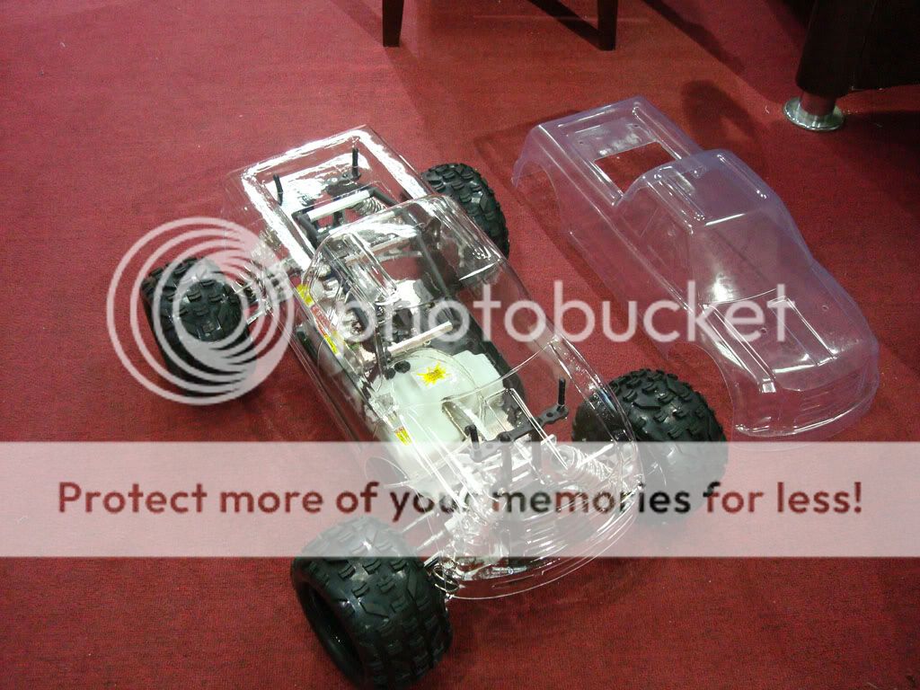

« Vastaus #347 : 07.04.10 - klo: 19.21 »
Muutama kuva TB2 PRO:sta
